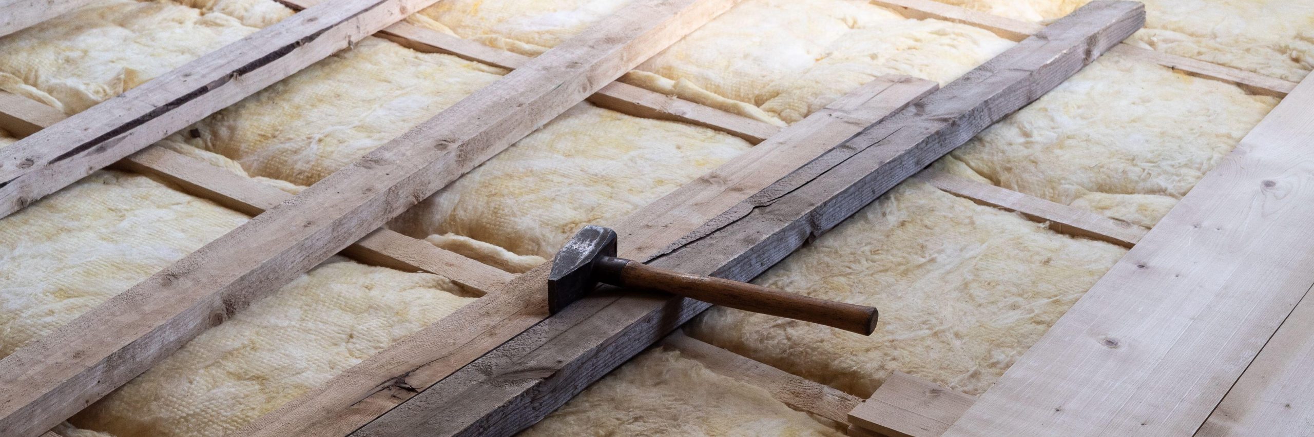

Selecting the right materials for a suspended floor is a critical decision. Rigid foam boards, while popular, may be undersized and need to account for service penetrations that could compromise their thermal integrity. Additionally, these boards are typically not vapor-permeable, which may lead to moisture-related issues over time. An alternative option is to use mineral wool, suspended on a membrane or support structure. This approach can be more effective in insulating the floor but may come with its own challenges.
Ideally, a continuous layer of insulation should be formed beneath the floor joists, rather than insulating between them, as the latter can create thermal bridges through the joists. This design should consider the minimum required depth beneath the joists and ground level, as well as the method of insulation suspension or support. The choice of material should align with the project’s specific needs and requirements. For projects with lower risk tolerance, an option is to reconstruct the entire suspended floor into a solid one, though this can be a costly, disruptive, and concrete-intensive endeavour.
