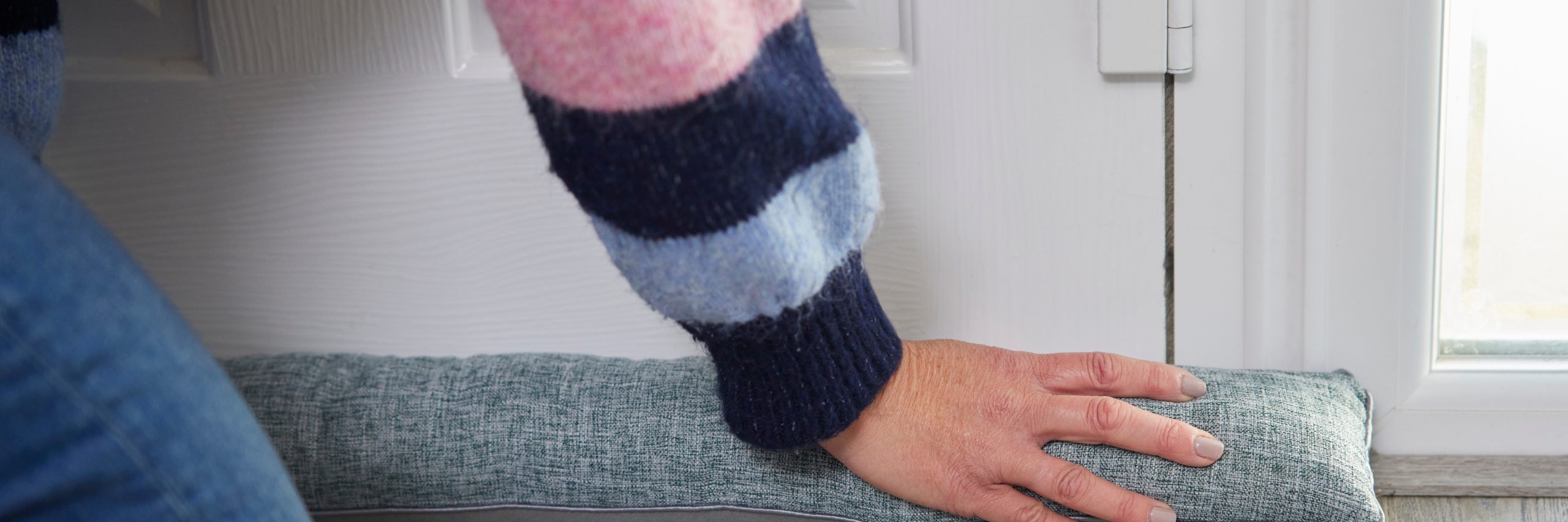

Draught excluders (long sausages made from any material and stuffing) can be placed anywhere in your home at the base of a door. The great thing about these are that they’re mobile, and you can make them yourself with any spare materials around the house (clothing, plastic bags, old cushions).
Draught excluders are most effective when they lead to a room that’s usually colder or unheated – ie. a utility room, spare room or kitchen.
