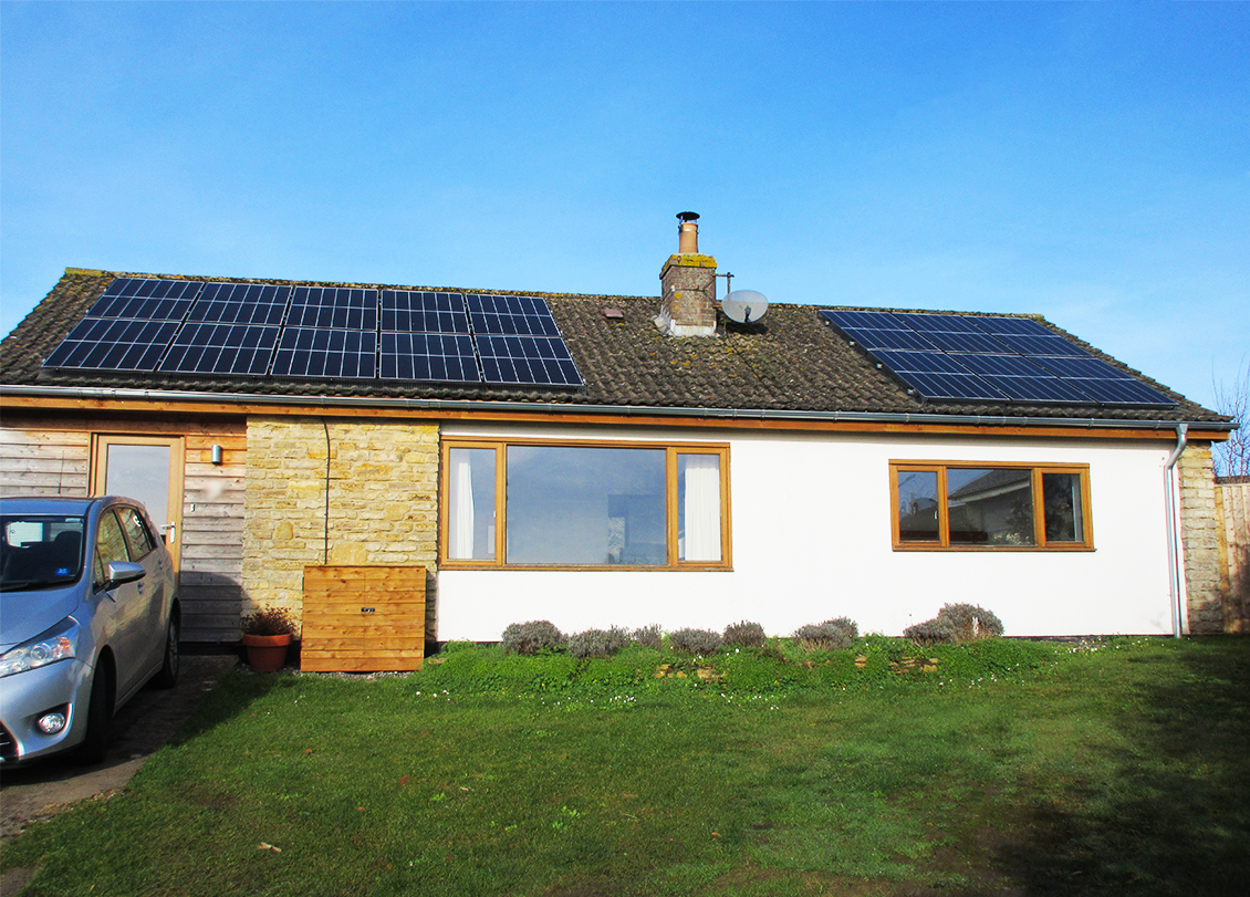

Mike and Mandy bought their 1960s bungalow nine years ago intending it to be their forever home. The property came with gas central heating and had UPVC windows installed in the 80s. Since purchase, the couple has changed the internal layout to include a conversion of a carport into the rest of the home, installed an air source heat pump, solar PV and battery storage. The windows, doors, and insulation have been updated along the way including extracting and refilling the cavity walls, improving loft insulation, and drylining some walls and window reveals to minimise thermal bridging and tackle mould. All windows and doors were replaced with timber double-glazed units.
The rise in energy bills and environmental concerns were key drivers for Mike and Mandy along with ensuring the building used as many healthy materials as possible following a “building biology approach“.
The couple, who live with their two adult children, upgraded their home in two phases. The first phase took place 2 years after they moved in and included new windows and doors, insulation, and the conversion of the carport into a liveable room. The second took place more recently in 2021-23 and involved installing a 5kW heat pump, 6.5kW solar PV and 13.5kW battery store.

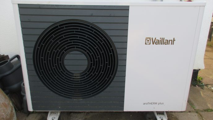

Vaillant aroTHERM 5kW Air Source Heat Pump

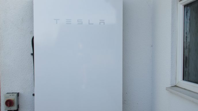

Tesla 13.5kW Solar Battery
Mandy was keen to get a heat pump after speaking to friends who had one installed and doing her own research. The Vaillant aroTHERM heat pump, including installation cost £12,000 and the solar PV was £5,000. A further 13.5kW Tesla battery storage was installed at a cost of £9,000 in 2023.
The couple used the Renewable Heat Incentive Scheme which means over seven years they will receive £1,000 a year from the government scheme as their heat source solely uses renewable energy. Because of energy prices going up the payback period for PV is decreasing considerably.

Further frustrations arose during the solar PV installation. The energy distributor, SSEN had to complete a witness statement to determine that it can’t export more than 5kW (the maximum allowed for SSEN customers). This took longer than expected and unfortunately meant it was 12 months before Mike and Mandy could export solar and start generating income.
Getting used to the heat pump was one of the most challenging factors to overcome. If all four family members showered in the morning, then the hot water cylinder was fully drained. The system prioritised hot water over space heating, so often there was no heating on cold days when this happened. This was due to the system being set up using many default settings. After contacting Vaillant, Mike re-set the system, so that now hot water and heating have a more equal split and the problems encountered previously have largely gone. It highlights the importance of having the system set up to meet your expectations and needs.
The heat controls also take some getting used to, quite often the family must ignore what the thermostat says and turn it up until they feel comfortable.
Over summer the heat pump goes off for heating and hot water comes either from the heat pump or directly via the solar instead.

The installation of the PV panels and battery has meant that for three months of the year, they are living off grid and even earning money by selling surplus solar back to the grid. They have noticed a warmer and more comfortable home during the colder months.
