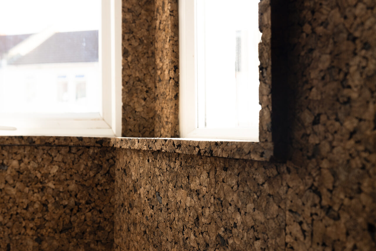

Following advice from Dan from BSB, Hugo and Mary decided to remove the plaster entirely, re-insulate with wood-fibre and other eco-friendly materials and replaster with lime and hemp. Bristol Sustainable Builders (BSB) were ideal for this approach, understanding the nuances of the building type, and how the heating strategy for the house was designed to work. They also gave friendly instruction for the DIY bits in the front rooms. Simon from Calch Cymru also took on part of the indoor lime plaster.

  • Cork and wood fibre internal wall insulation, 60mm to avoid condensation

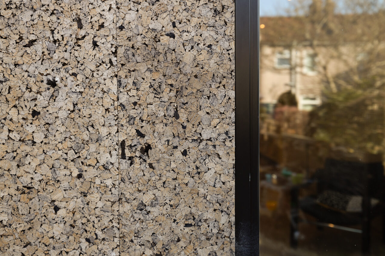

  • Wood fibre board external wall insulation at the back of the house, over pebble dash
