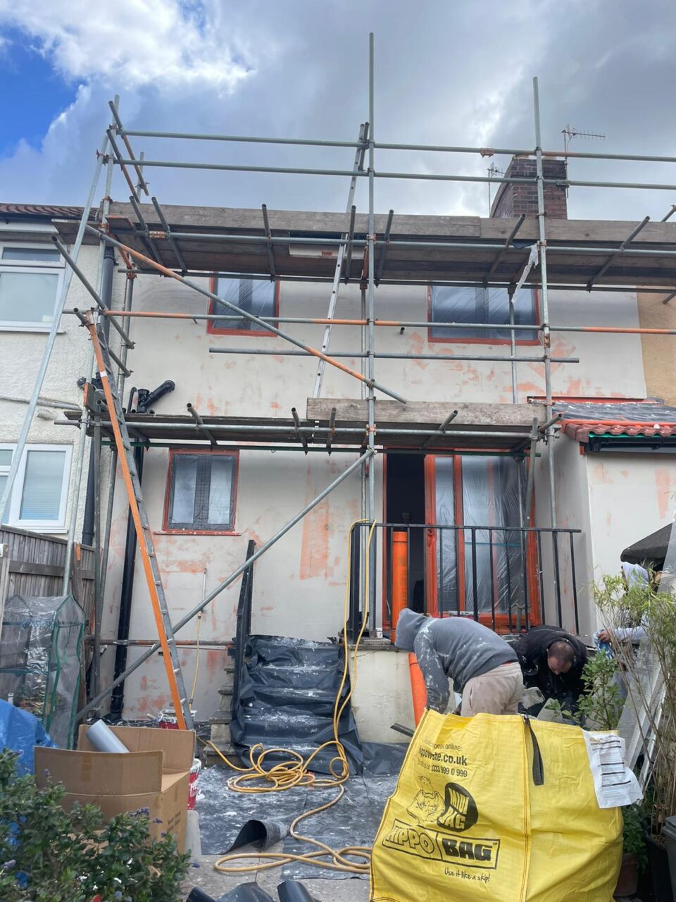

  • Render Removal

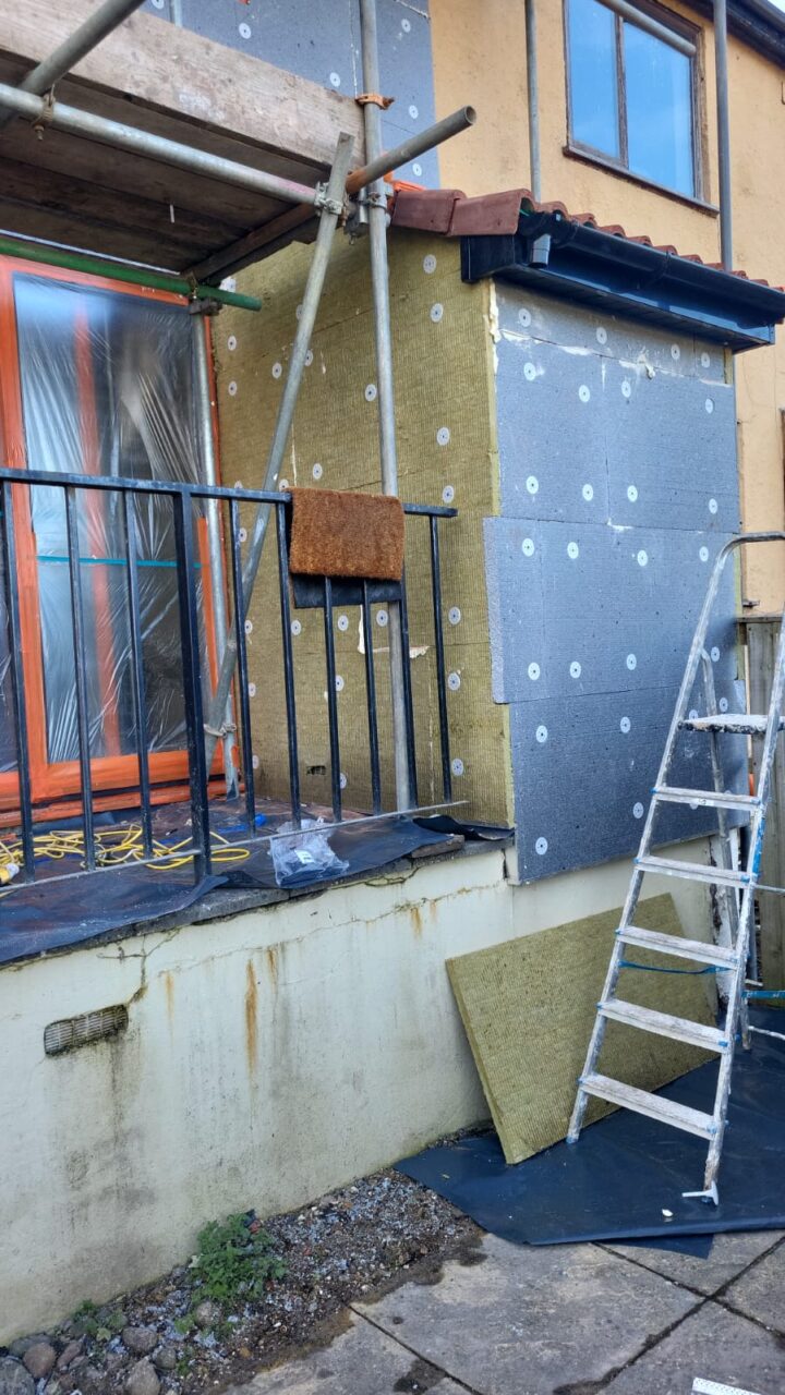

  • EWI Pro External Wall Insulation system, installed to PAS 2030:2019 specifications

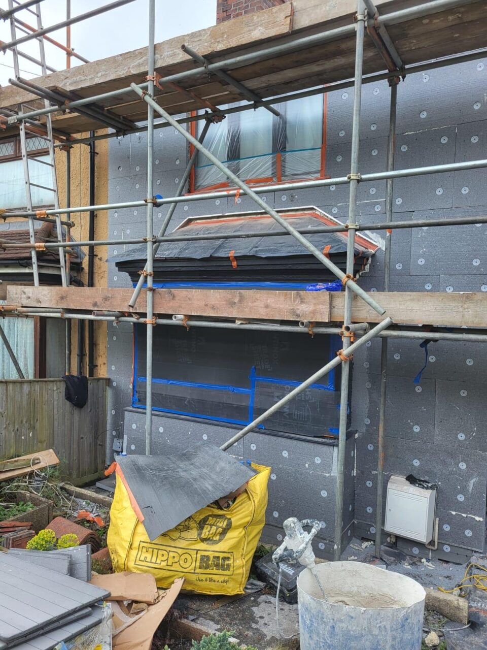

Jamel: The process of installing the render basecoat, meshing and topcoat to a high-quality finish on this property was threefold: starting with a hand-levelled basecoat; applying reinforcing mesh at stress points such as windows and doors; followed by the topcoat application and hand-levelling to ensure an even finish.

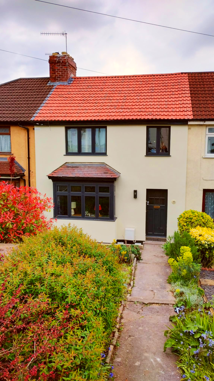

The whole project was rounded off with an inspection which gave the final sign-off on the quality of the work, up to PAS standards.

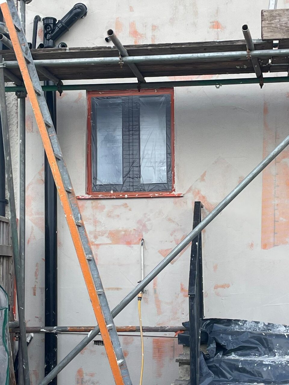

Jamel: During the render-removal stage at the beginning of the works, cracking was discovered at the corner of window openings. This resulted in a structural report being carried out to ensure the works could go ahead with the right advice and sign-off. The cracks needed to be ‘stitched’ correctly before any of the planned rendering works could take place. Following this, there was a delay to the programme which was regrettable but unavoidable.  Laying the correct ‘foundation’ for the render will always be preferrable to proceeding without, keeping the client happy with the quality of work.
