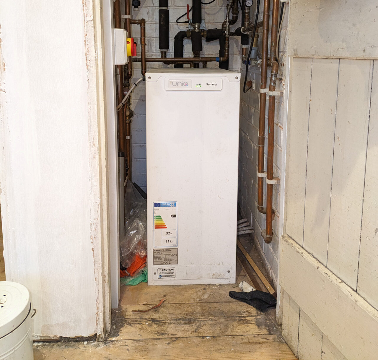

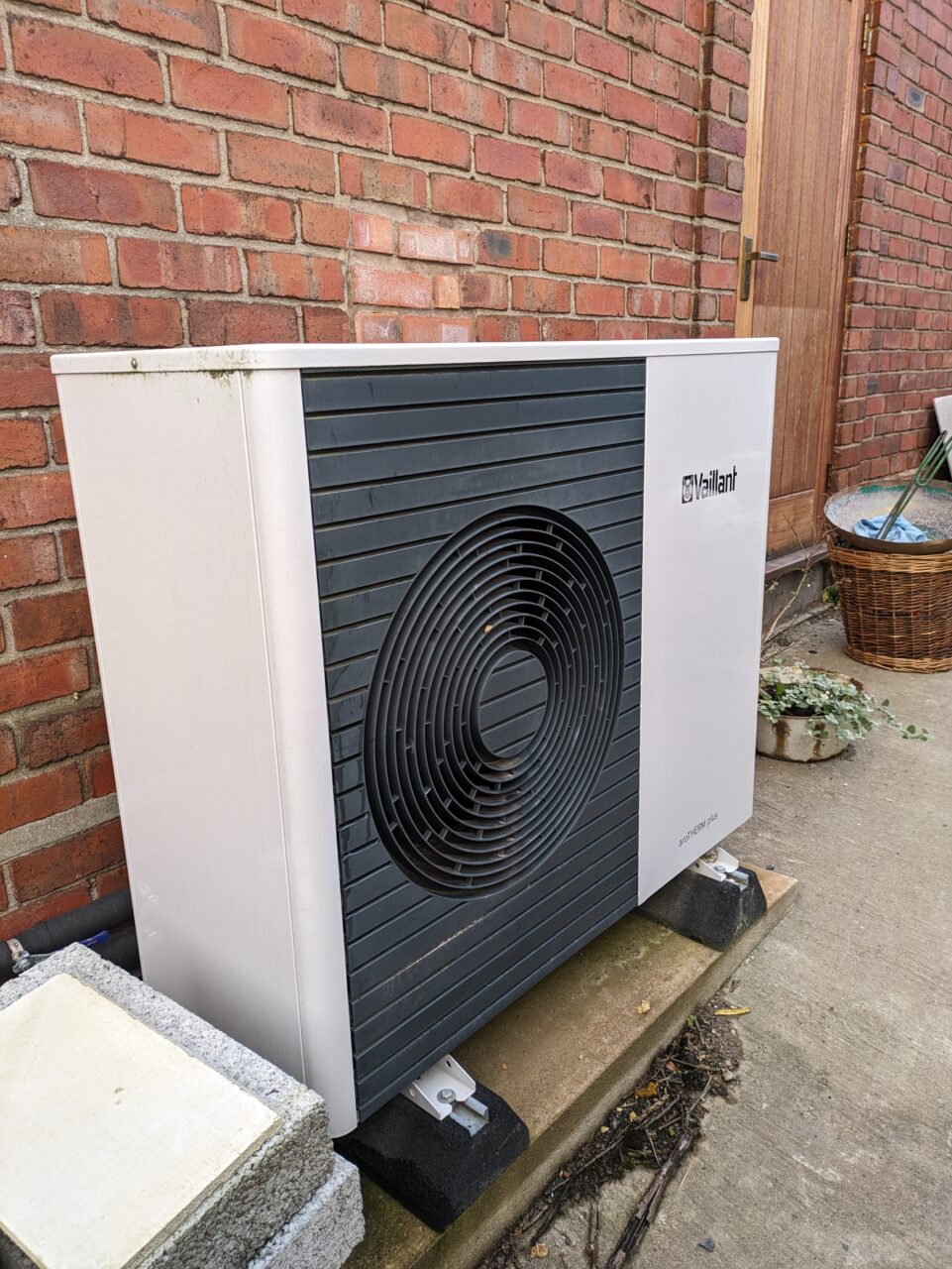

The project had a budget of £30,000, with a significant portion allocated to the £13,000 air source heat pump system, which included £3,000 to the SunAmp thermal store, both essential components of the retrofit. £7,000 towards the cost of the heat pump was contributed from the ECO3 Scheme.
Jenna from Futureproof conducted a shallow retrofit plan, examining the existing energy performance certificate (EPC) and floor plan. She advised on the feasibility of a heat pump and the type of underfloor heating that would work best. The assessment identified challenges related to the existing air gap, leading to recommendations for suitable installers.
The primary challenge arose from difficulties with the chosen installers. An initial quote from one installer suggested an oversized heat pump, but Hemma challenged this, based on her research and the advice she had received. Hemma ultimately opted for a lower output, but higher-spec Vaillant heat pump and SunAmp thermal store, recommended by a different installer. The SunAmp thermal store is 3 times smaller than a standard water tank which addressed Hemma and Tim’s space constraints.

Despite the challenges, Hemma and Tim’s renovated home is now more comfortable in both summer and winter and their energy consumption has reduced dramatically, thanks to the improved fabric (new windows and floor insulation) and combination of the heat pump and underfloor heating. The couple now use only 15 kWh per day in winter and 6 kWh in summer. This is a 68% reduction on their previous usage, improving their EPC rating from a 66D to a 78C*.
The Vaillant heat pump and SunAmp thermal store have proven effective, although communication challenges persist in explaining the system to other heating engineers.
