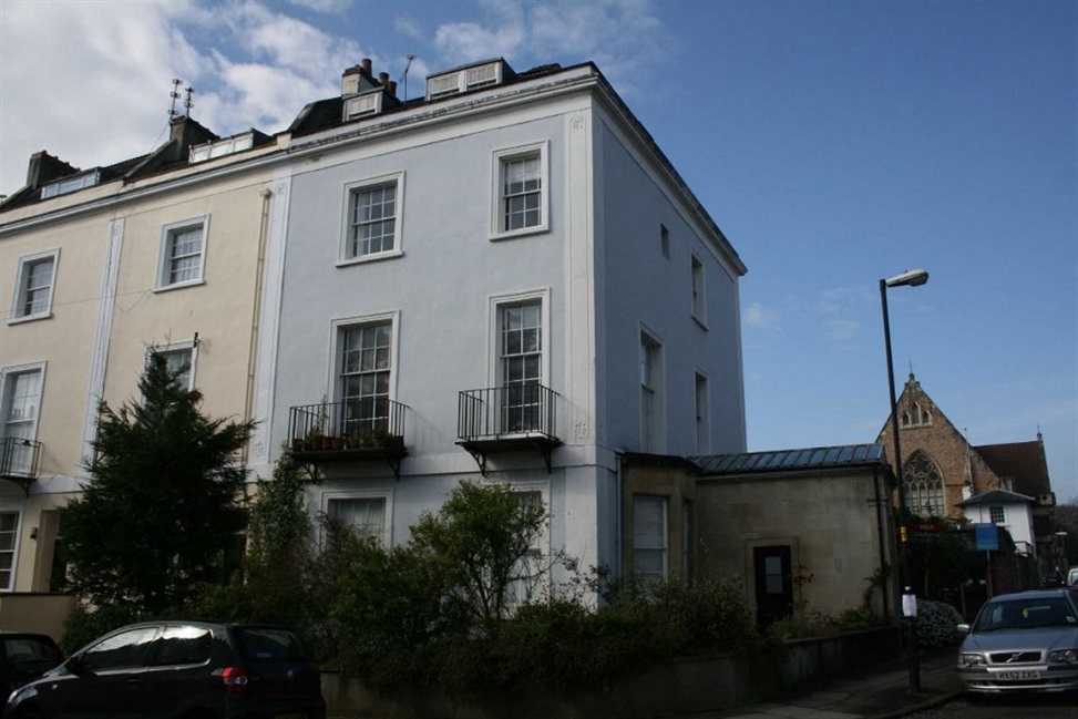

The Home:
House Type: 1st Floor Flat, Georgian Property (Conservation Area)
No. of bedrooms: 2
Wall Type: Solid Wall
Area: Bristol
“The flat is now rented out to tenants who appreciate its warmth and comfort.”
– Rob, Landlord
Rob owns a first floor flat in Clifton, which, typical of properties built during this era, was draughty and difficult to heat. Determined to improve its energy efficiency and comfort, Rob undertook several modifications, including draft-proofing, secondary glazing on the sash windows, and internal wall insulation. He also installed a suspended ceiling which reduces the heat loss through the ceiling and the volume of the flat (so there is less air to heat) while maintaining the proportions of the room.
The property was converted into flats without planning permission during the 1980s. Most of the cornicing was lost by creating stud walls to divide the rooms. Fireplaces were removed and covered up. Retrospective planning permissions were granted in the early 1990’s. The property is a north facing Georgian end-terrace with large single-glazed sash windows, high ceilings and, when Rob moved in, no cavity or wall insulation. Rob was spurred on by his concern about climate change and a desire to be more comfortable.
